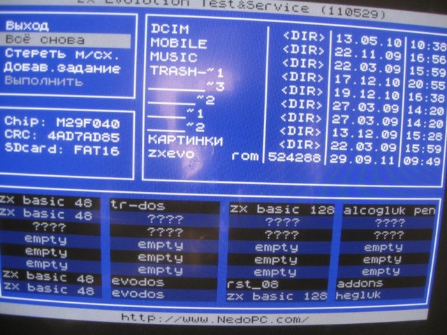

There is standard ROM map like this download/file.php?id=1556&t=1
Main working pages are four last ones, you shouldn't mix their order. Other blocks of 4 pages can be used as alternative 128k rom sets (like first 4 ones) or just for something else as in this picture, for profrom from Scortion.

justine wrote:Also how would i select which 16k rom ? like 48k or 128k roms or services rom ?
48k=page0 ROM
tr-dos6_12e=page1 ROM
128k=page2 ROM
sys=page3 ROM
